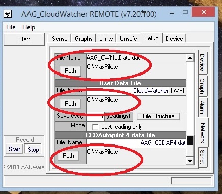

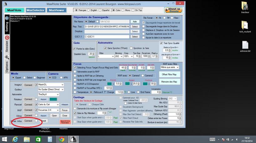

For installing AAG cloudwatcher to work with maxpilote
- the first step is to install aagcw software and the directory c:\maxpilote

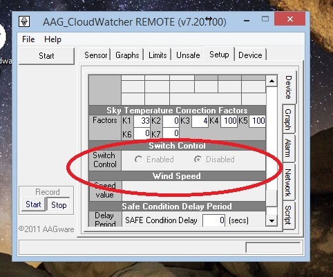

-the second step is to enabled the switch control
-the third step is to change the three directory on the aag cw software
setup->network
and after that it will work
I hope it will help you to install and to run the aag cw
