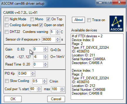

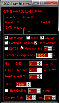

New driver is out, in the usual place. Version 0.7.2L. Screenshots are here (I cannot find a button to insert images on this forum unless they are hosted elsewhere).
Changes:
- Fix bug where maxGain was reported as 64 instead of 63
- Modify the layout of the settings form
- Add a button to minimise the settings form
- Add a button to toggle between image info only or settings as well when camera is connected
The biggest visual change is that I have modified the window layout to look more like EQASCOM. You can minimise the window now as well.
The firmware stays the same, v.0.6L.
(there is a testing firmware version v0.7L in the same folder, ignore for now unless you have cooling issues).
Enjoy

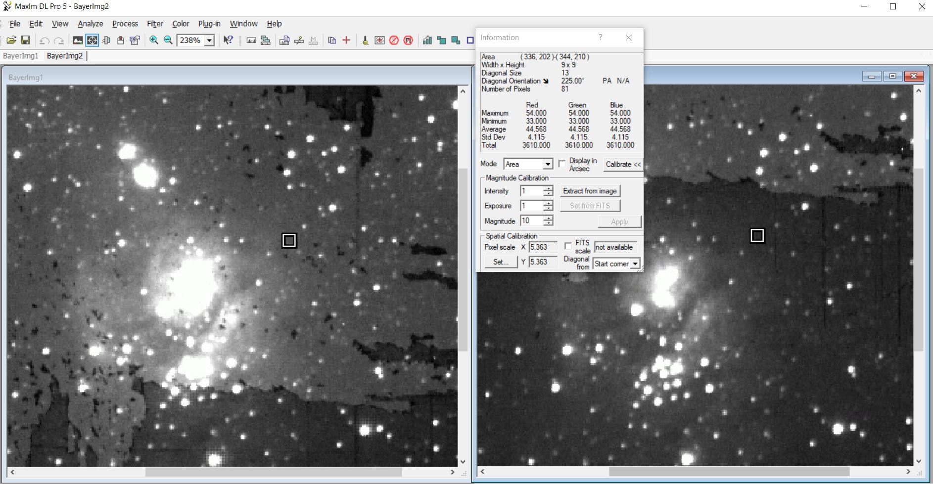

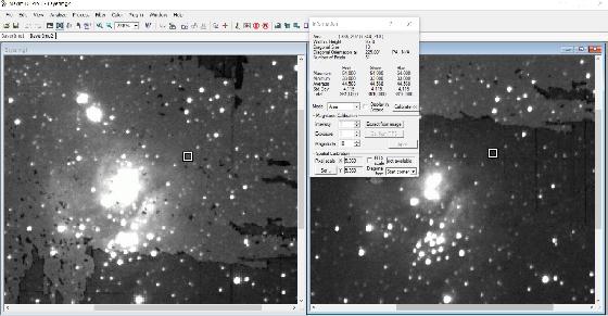

More than a test on removing the Bayer matrix, it shows significant loss in intensity by conversion to mono. On page 4 there is a graph of intensities of the sensor vs wavelength, measured with a monochromator. The bad news is that by removing the Bayer matrix and the microlenses the intensity in H alpha red (660nm) goes down by 2.8 times. Similar for the other wavelengths.
If binning is used mono still wins (4x / 2.8x = 1.4x higher intensity) but then there is no resolution gain.

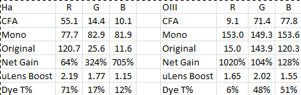

Haha, and more results from the same page. These measurements show that the mono sensor is actually more sensitive than the colour sensor. Interesting, interesting...
YESSS, it confirms the results of another website
Hi There,
I made a comparison (On stars not burned and on part of sky with no stars) between the 2 images Bayerized and unBayerized.... As you said Luka, it seems interesting....
But, only on the sensitivity point of view. I have compared Sensitivity... And Yes it is more sensitive but I Have also compared noise....... And I aaw that noise is increasing faster than sensitivity... :cry:
It seems that removing the bayer matrix make the image more noisy that it should by just the effect of sensitivity.
Signal/noise ratio is better on the unBayerized image by 10% to 25%... It means that if you want to have the same "image quality", you shoud pose longer on the unBayerized image that on the Bayerized.. But, if you don't care about noise, then yes removing the bayer mask is good.
