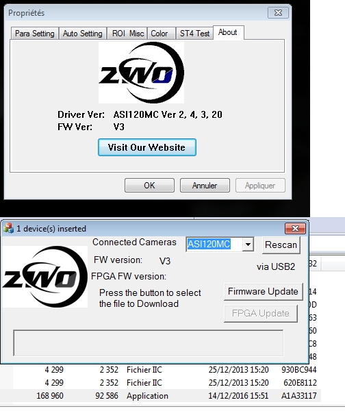

Patrice, the reason I asked about the firmware is that if this camera is identical to the ASI120MM it may be even running the original ZWO firmware. In that case it could be using an older version of the ASI120MM firmware which may have bugs (the latest firmware version is 1.3).
Furthermore, ZWO provides a compatible version of the same firmware v1.3 which solves issues with black photos.
And of course, if the camera is running the original ZWO firmware, we could benefit from the future upgrades.
In the ASCOM driver settings, does the driver mention the firmware version anywhere?
Alternatively, on the driver website under "SDK and upgrade tool" there is firmware flashing software. I ran the windows version (without the camera) and it looks like it can read the firmware and FPGA firmware versions, without flashing the new firmware.
This may be a way to check which firmware version the T7 is running.
(I don't have the camera yet so I cannot do any tests myself)
Luka

Pour le firmware, c'est la version 3 qui est installé, vérifié avec le logiciel de ZWO et sur AMCap qui est livré avec, voir les images dessous, donc à moins que je me trompe elle est à jour;)
LUKA,
For firmware, it's the v3 installed, checked with the software of ZWO and AMCap, see the pictures, so unless I'm wrong it is the last and it's possible to upgrade for next ;)

Donc pour PHD il faut utiliser le pilote ASCOM mais après l' apéro :be:
