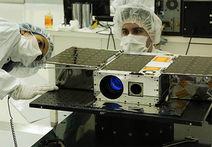

Le 20 novembre 2017 l'ISS a largué ASTERIA, un cubSat de 12 kg (10x20x30 cm) sur une orbite de 402 km d'altitude
C'est un démonstrateur qui a pour objectif de pointer les étoiles brillantes et faire de la photométrie
ça fonctionne et la mission est prolongée :
https://www.jpl.nasa.gov/news/news.php?release=2018-072
Mission managers at NASA's Jet Propulsion Laboratory in Pasadena, California, recently announced that ASTERIA has accomplished all of its primary mission objectives, demonstrating that the miniaturized technologies on board can operate in space as expected. This marks the success of one of the world's first astrophysics CubeSat missions, and shows that small, low-cost satellites could be used to assist in future studies of the universe beyond the solar system
