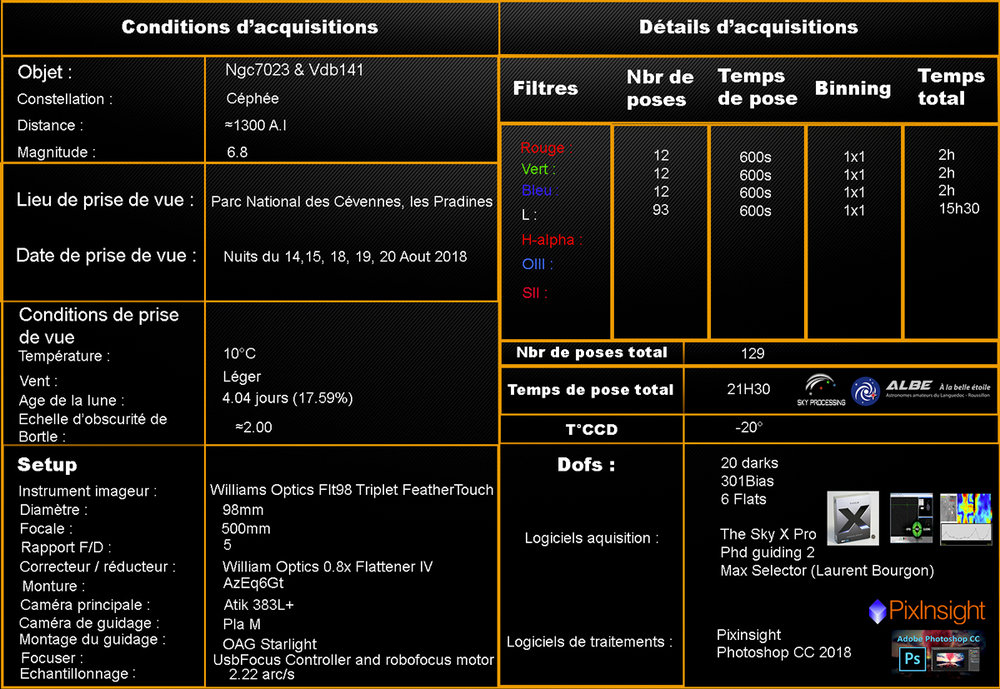

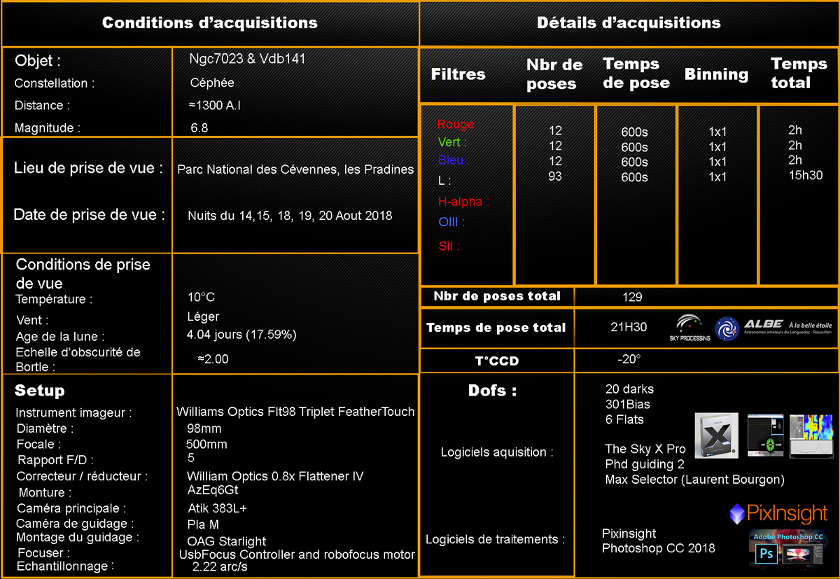

Quasiment 22h de pose au total, 93x600s L, 12x600s R, 12x600V, 12x600s B.
Williams Optics Flt98, Atik 383L+
