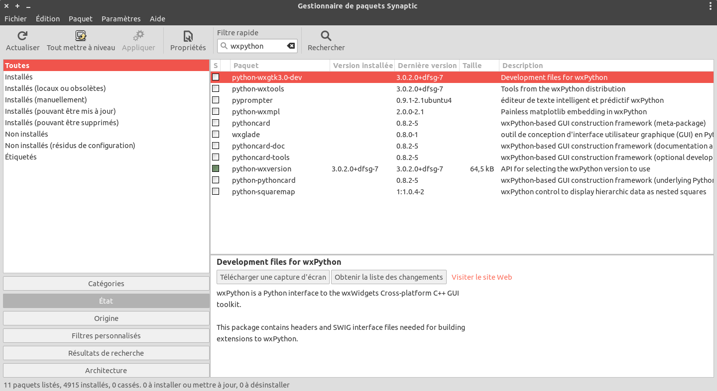

Traou Mad Posté 16 juin 2019 Posté 16 juin 2019 Le 15/06/2019 à 22:11, m27trognondepomme a dit : Les linuxien devront installer le package wxpython. Les tests sous linux n'ont pas été trop poussés, j'espère que je n'ai pas laissé de gros et méchant bugs 👿 Voir davantage Salut ! Chez moi, (ubuntu 18.04) j'ai pas wxpython, juste cette liste : Dans le doute, j'ai rien installé. Et quand j'ai lancé dans un terminal sirilic.pyw, j'ai eu ces messages : eric@Mirphak:~$ '/home/eric/sirilic/sirilic/Sirilic.pyw' (Sirilic.pyw:10482): Gtk-WARNING **: 21:15:30.508: Theme parsing error: gtk.css:27:35: Junk at end of value for background-color (Sirilic.pyw:10482): Gtk-WARNING **: 21:15:30.508: Theme parsing error: gtk.css:40:48: Junk at end of value for background-color (Sirilic.pyw:10482): Gtk-WARNING **: 21:15:30.508: Theme parsing error: gtk.css:48:46: Junk at end of value for background-color (Sirilic.pyw:10482): Gtk-WARNING **: 21:15:30.508: Theme parsing error: gtk.css:59:58: Junk at end of value for background-color (Sirilic.pyw:10482): Gtk-WARNING **: 21:15:30.508: Theme parsing error: gtk.css:66:28: The :prelight pseudo-class is deprecated. Use :hover instead. (Sirilic.pyw:10482): Gtk-WARNING **: 21:15:30.508: Theme parsing error: gtk.css:70:46: Junk at end of value for background-color (Sirilic.pyw:10482): Gtk-WARNING **: 21:15:30.508: Theme parsing error: gtk.css:77:35: The :prelight pseudo-class is deprecated. Use :hover instead. (Sirilic.pyw:10482): Gtk-WARNING **: 21:15:30.508: Theme parsing error: gtk.css:81:58: Junk at end of value for background-color (Sirilic.pyw:10482): Gtk-WARNING **: 21:15:30.508: Theme parsing error: gtk.css:123:31: The :insensitive pseudo-class is deprecated. Use :disabled instead. (Sirilic.pyw:10482): Gtk-WARNING **: 21:15:30.508: Theme parsing error: gtk.css:124:24: The :insensitive pseudo-class is deprecated. Use :disabled instead. (Sirilic.pyw:10482): Gtk-WARNING **: 21:15:30.508: Theme parsing error: gtk.css:156:27: The :insensitive pseudo-class is deprecated. Use :disabled instead. (Sirilic.pyw:10482): Gtk-WARNING **: 21:15:30.508: Theme parsing error: gtk.css:157:29: The :insensitive pseudo-class is deprecated. Use :disabled instead. (Sirilic.pyw:10482): Gtk-WARNING **: 21:15:30.508: Theme parsing error: gtk.css:177:34: The :insensitive pseudo-class is deprecated. Use :disabled instead. (Sirilic.pyw:10482): Gtk-WARNING **: 21:15:30.509: Theme parsing error: gtk.css:199:34: The :inconsistent pseudo-class is deprecated. Use :indeterminate instead. Traceback (most recent call last): File "/home/eric/sirilic/sirilic/Sirilic.pyw", line 115, in <module> main() File "/home/eric/sirilic/sirilic/Sirilic.pyw", line 111, in main app = MyApp(0); File "/usr/lib/python2.7/dist-packages/wx-3.0-gtk3/wx/_core.py", line 8628, in __init__ self._BootstrapApp() File "/usr/lib/python2.7/dist-packages/wx-3.0-gtk3/wx/_core.py", line 8196, in _BootstrapApp return _core_.PyApp__BootstrapApp(*args, **kwargs) File "/home/eric/sirilic/sirilic/Sirilic.pyw", line 54, in OnInit i_gui = gui.CGui(None, -1, "") # instance Sirilic GUI File "/home/eric/sirilic/sirilic/gui/gui.py", line 423, in __init__ self.__set_properties() File "/home/eric/sirilic/sirilic/gui/gui.py", line 438, in __set_properties self.listProject.AppendColumn(_("Object"), format=wx.LIST_FORMAT_LEFT, width=-1) AttributeError: 'ListCtrl' object has no attribute 'AppendColumn' Bon, ça ne s'est pas ouvert... 🤔
m27trognondepomme Posté 16 juin 2019 Auteur Posté 16 juin 2019 (modifié) utilise plutôt python3: sudo apt install python3 sudo apt install python3-wxgtk4 et après: python3 Sirilic.pyw Modifié 16 juin 2019 par m27trognondepomme
Traou Mad Posté 16 juin 2019 Posté 16 juin 2019 python3 est déjà la version la plus récente (3.6.7-1~18.04). Par contre : E: Impossible de trouver le paquet python3-wxgtk4
m27trognondepomme Posté 16 juin 2019 Auteur Posté 16 juin 2019 (modifié) Mon interface graphique a été générée en wxpython4 et la diversité des distributions (linux archlinux, ubuntu ... ,et aussi windows ) fait que certaines fonctionnent encore wxpthon3. Récupères la version du dépôt git de sirilic , ça doit corriger le problème : git clone https://gitlab.com/free-astro/sirilic.git et installes python3-wxgtk3 Modifié 16 juin 2019 par m27trognondepomme
m27trognondepomme Posté 16 juin 2019 Auteur Posté 16 juin 2019 Le 16/06/2019 à 19:35, Traou Mad a dit : python3 est déjà la version la plus récente (3.6.7-1~18.04). Par contre : E: Impossible de trouver le paquet python3-wxgtk4 Voir davantage Je ne suis pas sur que tu utilises python3 dans le message d'erreur , c'est du python2.7 Le 16/06/2019 à 19:24, Traou Mad a dit : File "/usr/lib/python2.7/dist-packages/wx-3.0-gtk3/wx/_core.py", line 8196, in _BootstrapApp return _core_.PyApp__BootstrapApp(*args, **kwargs) Voir davantage
m27trognondepomme Posté 16 juin 2019 Auteur Posté 16 juin 2019 (modifié) si tu fais : python --version ça me donnera le numéro de version Modifié 16 juin 2019 par m27trognondepomme
Traou Mad Posté 16 juin 2019 Posté 16 juin 2019 Python 2.7.15rc1 Je comprends pas, puisque python3 est aussi installé... python3 est déjà la version la plus récente (3.6.7-1~18.04).
dragonlost Posté 16 juin 2019 Posté 16 juin 2019 Le 16/06/2019 à 19:54, Traou Mad a dit : Python 2.7.15rc1 Je comprends pas, puisque python3 est aussi installé... python3 est déjà la version la plus récente (3.6.7-1~18.04). Voir davantage Hello. Tu doit préciser python3 dans le terminal car python3 n'est pas la mise a jour de python 2 mais une nouvelle version de python c'est pour ça que python 3 n'a pas remplacer python 2.
Traou Mad Posté 16 juin 2019 Posté 16 juin 2019 Le 16/06/2019 à 20:02, dragonlost a dit : Hello. Tu doit préciser python3 dans le terminal car python3 n'est pas la mise a jour de python 2 mais une nouvelle version de python c'est pour ça que python 3 n'a pas remplacer python 2. Voir davantage C'est ce que je me suis dit après coup...
dragonlost Posté 16 juin 2019 Posté 16 juin 2019 Par défaut sur la plupart des distributions tu as python2 qui est utilisée par la commande python.
dragonlost Posté 16 juin 2019 Posté 16 juin 2019 Le 16/06/2019 à 20:05, Traou Mad a dit : C'est ce que je me suis dit après coup... Voir davantage C'est du au fait que beaucoup de logiciel sur les systèmes d'exploitation utilise encore python 2. Mais ça vas changer car python 2 a etait déclarer obsolète.
dragonlost Posté 16 juin 2019 Posté 16 juin 2019 Le 16/06/2019 à 20:01, Traou Mad a dit : j'ai fait : python3 --version Python 3.6.7 Voir davantage Si tu as Ubuntu bionic (18.04 ou plus) tu peut installer : python3-wxgtk4.0
m27trognondepomme Posté 16 juin 2019 Auteur Posté 16 juin 2019 (modifié) avec python3 , il faut installer le package python-wxgtk4.0 ( sudo apt install python-wxgtk4.0) Python pointe majoritairement encore sur Python2.7 ( debian,ubuntu) pourtant cette version qui date ne sera plus maintenu à partir de 2020. En tant que développeur , cette rétro-compatibilité m'apporte pas mal de soucis (pour rester poli) et je me demande si je ne vais pas arrêter le support. Déjà entre les OS (linux,mac et windows) ce n'est pas simple . Modifié 16 juin 2019 par m27trognondepomme
dragonlost Posté 16 juin 2019 Posté 16 juin 2019 Le 16/06/2019 à 20:12, m27trognondepomme a dit : Voir davantage Le 16/06/2019 à 20:12, m27trognondepomme a dit : avec python3 , il faut installer le package python-wxgtk4.0 ( sudo apt install python-wxgtk4.0) Python pointe majoritairement encore sur Python2.7 ( debian,ubuntu) pourtant cette version qui date ne sera plus maintenu à partir de 2020. En tant que développeur , cette rétro-compatibilité m'apporte pas mal de soucis (pour rester poli) et je me demande si je ne vais pas arrêter le support. Déjà entre les OS (linux,mac et windows) ce n'est pas simple . Voir davantage Sur mes programmes en python 3 ai déjà abandonner la retro-compatibilite. C'est beaucoup de temps perdu qui sera jeter a la poubelle d'ici 1 ans ou 2.
m27trognondepomme Posté 16 juin 2019 Auteur Posté 16 juin 2019 Le 16/06/2019 à 20:48, dragonlost a dit : Sur mes programmes en python 3 ai déjà abandonner la retro-compatibilite. C'est beaucoup de temps perdu qui sera jeter a la poubelle d'ici 1 ans ou 2. Voir davantage ça me conforte. 👍 En attendant de scier la branche 2.7, voici la version officielle V1.01 qui corrige le problème (et 1 petit bug). c'est disponible ici : astroslacholet.wordpress.com ou directement sur https://gitlab.com/free-astro/sirilic
