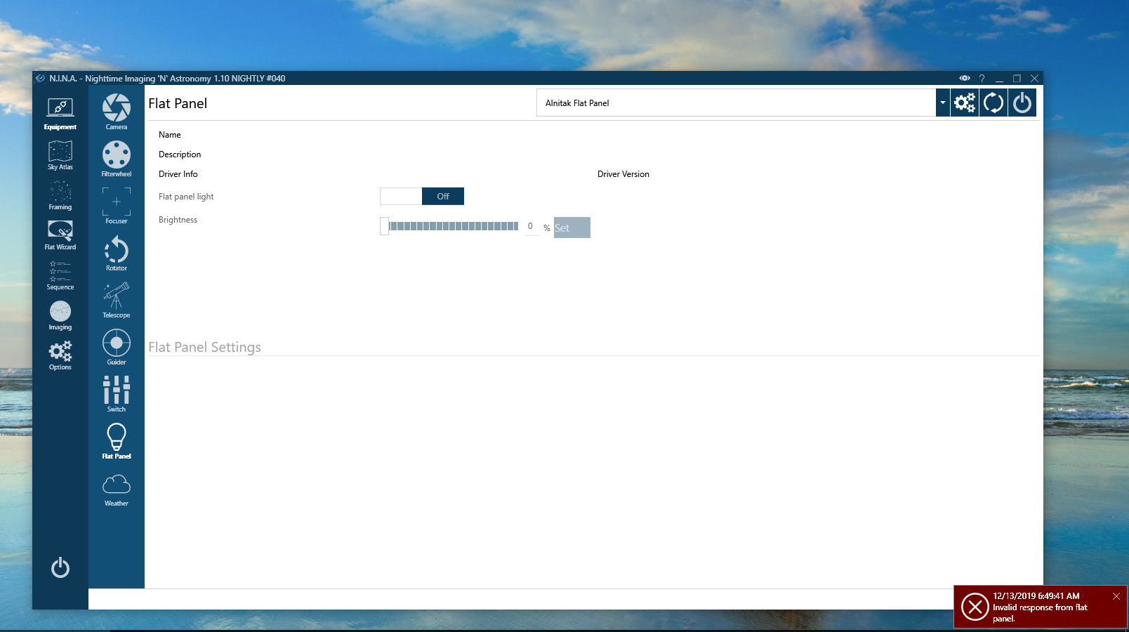

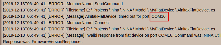

Hi, I think I can provide screenshot but log file ..... no idea where to generate it  😅
Actually I do not know how to write in french. Also need to google translate for it too. 😅
I think I got something:
[2019-12-13T06: 49: 41] [ERROR] [MemberName] SendCommand
[2019-12-13T06: 49: 41] [ERROR] [FileName] E: \ Projects \ nina \ NINA \ Model \ MyFlatDevice \ AlnitakFlatDevice. cs
[2019-12-13T06: 49: 41] [ERROR] [Message] AlnitakFlatDevice: timed out for port: COM16
[2019-12-13T06: 49: 41] [ERROR] [MemberName] Connect
[2019-12-13T06: 49: 41] [ERROR] [Message] Invalid response from flat device on port COM16. Command was: NINA.Utility.FlatDeviceSDKs.AlnitakSDK.FirmwareVersionCommand Response was: FirmwareVersionResponse:.

sur ta log on voit que NINA cherche sur le port COM16 :
Alors qu'il est branché sur le COM14 :

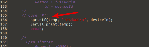

Il n'y a pas un problème, là ?
pourquoi c'est commenté ??
