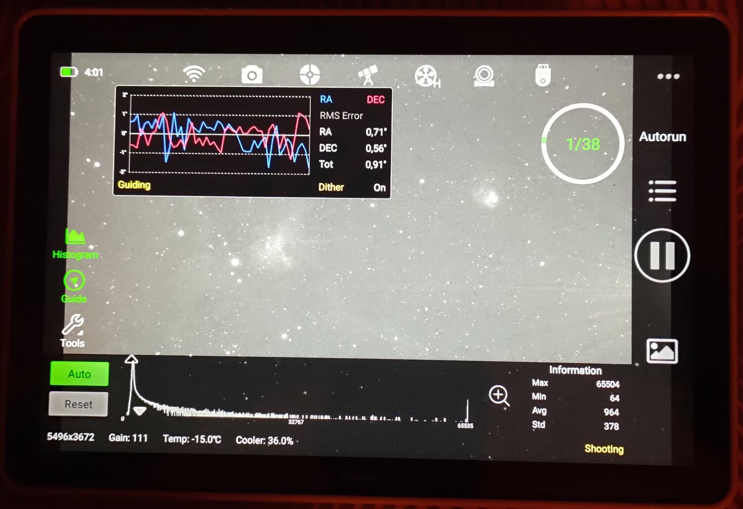

Premier Autorun de l'Asiair et nouvelle question :)
J'ai coché un retournement au méridien automatique mais j'aimerai bien voir comment ça se passe, sait-on jamais... Je ne trouve pas l'heure à laquelle ça va se déclencher, l'info existerait-elle quelque part ?
@Sebriviere
Le log de l'autofocus demandé pour une variation de 2 degrés (14,4° à 12,28°)
2020/10/30 20:42:44 [AutoFocus|Begin]: Run AF when temperature changed X degrees, 14.4¡æ changed to 12.28¡æ, exposure 10s Bin2, temperature 12.32¡æ
2020/10/30 20:42:44 [Guide]: Stop Guiding
2020/10/30 20:42:44: Find Focus Star
2020/10/30 20:42:57: Find Focus Star: detect and calculate star HFD 2.4 ,  EAF position 9972
2020/10/30 20:42:57: Find Focus Star: finding an appropriate star(421,597) HFD 2.4 Brightness 1398
2020/10/30 20:43:15: Find Focus Star: detect and calculate star HFD 12.6 ,  EAF position 10122
2020/10/30 20:43:15: Calculate V-Curve
2020/10/30 20:43:28: Calculate V-Curve: detect and calculate star HFD 9.3 ,  EAF position 10122
2020/10/30 20:43:41: Calculate V-Curve: detect and calculate star HFD 8.4 ,  EAF position 10092
2020/10/30 20:43:55: Calculate V-Curve: detect and calculate star HFD 6.5 ,  EAF position 10062
2020/10/30 20:44:09: Calculate V-Curve: detect and calculate star HFD 5.1 ,  EAF position 10032
2020/10/30 20:44:22: Calculate V-Curve: detect and calculate star HFD 2.4 ,  EAF position 10002
2020/10/30 20:44:36: Calculate V-Curve: detect and calculate star HFD 2.8 ,  EAF position 9972
2020/10/30 20:44:49: Calculate V-Curve: detect and calculate star HFD 6.2 ,  EAF position 9912
2020/10/30 20:45:02: Calculate V-Curve: detect and calculate star HFD 9.6 ,  EAF position 9882
2020/10/30 20:45:16: Calculate V-Curve: detect and calculate star HFD 10.5 ,  EAF position 9852
2020/10/30 20:45:29: Calculate V-Curve: detect and calculate star HFD 14.4 ,  EAF position 9822
2020/10/30 20:45:34: Find Focus Point
2020/10/30 20:45:47: Find Focus Point: detect and calculate star HFD 5.6 ,  EAF position 10050
2020/10/30 20:46:01: Find Focus Point: detect and calculate star HFD 5.6 ,  EAF position 10035
2020/10/30 20:46:14: Find Focus Point: detect and calculate star HFD 4.2 ,  EAF position 10020
2020/10/30 20:46:28: Find Focus Point: detect and calculate star HFD 2.8 ,  EAF position 10005
2020/10/30 20:46:41: Find Focus Point: detect and calculate star HFD 2.3 ,  EAF position 9990
2020/10/30 20:46:41 [AutoFocus|End]: Auto focus succeeded
Edit 1 : Je n'ai pas une grosse variation de FWHM à 2° sur cette lunette que je je viens d'avoir et donc que je ne connais pas encore bien. Je trouve dommage de ne pas pouvoir paramétrer plus finement l'écart de température pour déclencher l'AF que sur 1°, 2° et 5°...
Edit 2 : J'ai trouvé pour le passage au méridien, c'est dans Autorun. Ça indique le temps qu'il reste avant le passage au méridien !
