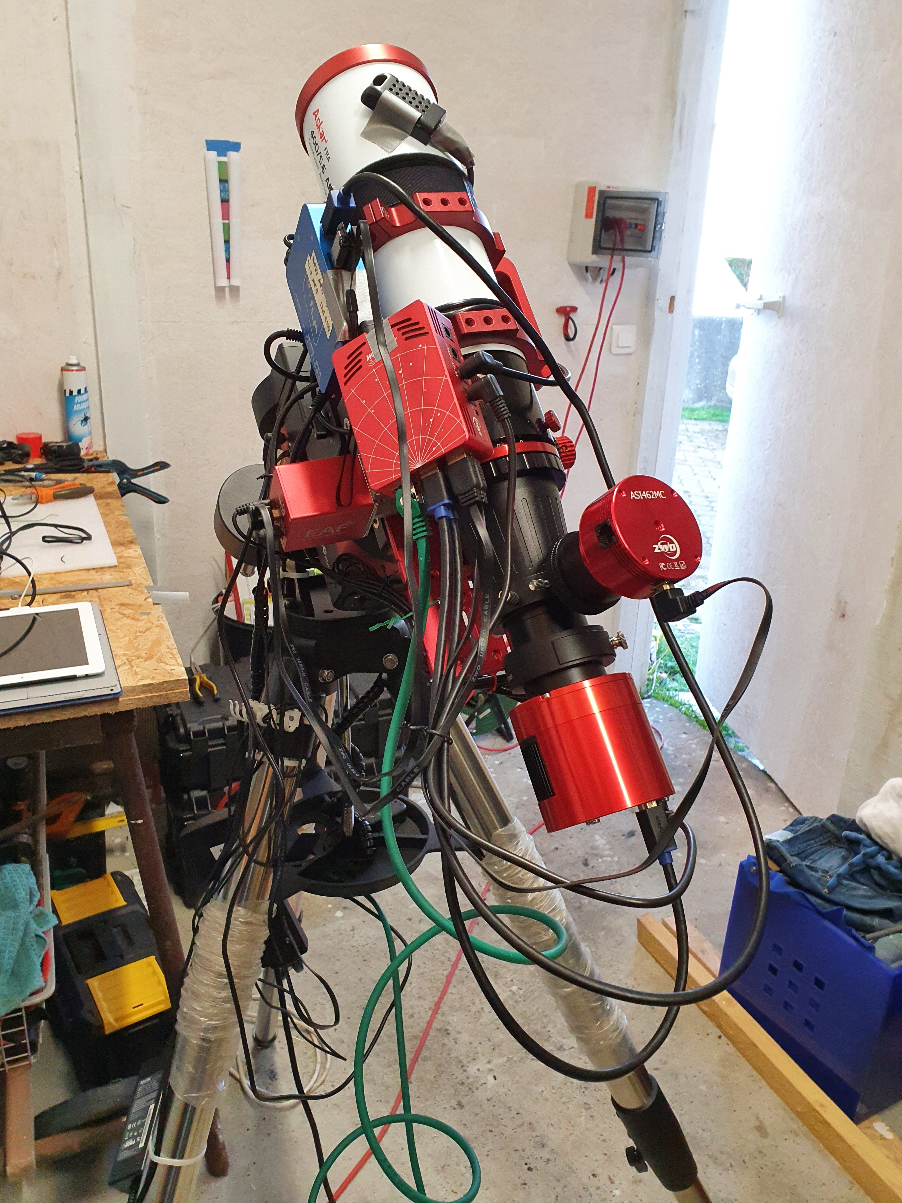

Sebriviere Posté 7 novembre 2020 Posté 7 novembre 2020 il y a 16 minutes, Phil49 a dit : Quel intérêt d'utiliser des rondelles alors que tu peux tourner ta cam ? Si ton montage est via PO, tu tournes oui... Le mien est vissé en M48 avant DO, puis porte filtre et M42 cam 533MC-P. Donc que du vissé. Citer

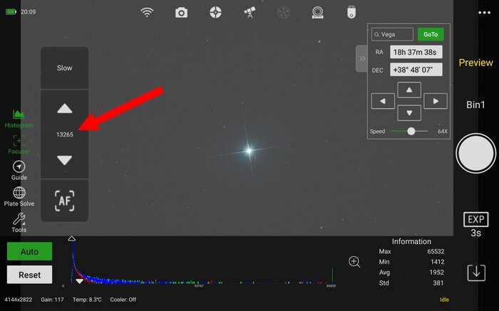

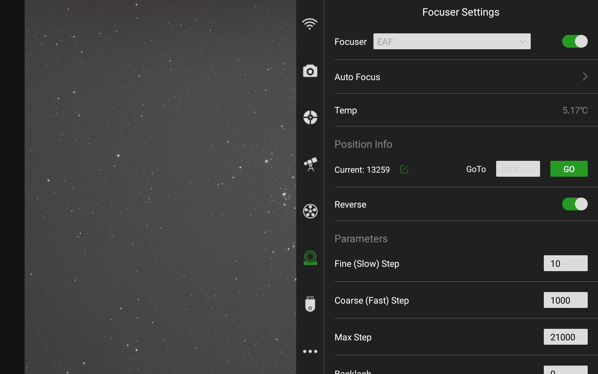

Titophe Posté 7 novembre 2020 Posté 7 novembre 2020 il y a 28 minutes, Phil49 a dit : Bonsoir Titophe, Où vois-tu un 2,6, moi la seule valeur que je vois c'est 2,99 qui n'est ni l'une ni l'autre ligne mises en gras ! 🤔 Philippe Dans ta séquence d’auto focus : 2020/11/04 22:43:20: Calculate V-Curve2020/11/04 22:43:26: Calculate V-Curve: detect and calculate star HFD 6.8 , EAF position 134152020/11/04 22:43:33: Calculate V-Curve: detect and calculate star HFD 6.9 , EAF position 133852020/11/04 22:43:40: Calculate V-Curve: detect and calculate star HFD 6.4 , EAF position 133552020/11/04 22:43:47: Calculate V-Curve: detect and calculate star HFD 5.0 , EAF position 133252020/11/04 22:43:54: Calculate V-Curve: detect and calculate star HFD 3.8 , EAF position 132952020/11/04 22:44:01: Calculate V-Curve: detect and calculate star HFD 2.8 , EAF position 132652020/11/04 22:44:08: Calculate V-Curve: detect and calculate star HFD 2.6 , EAF position 132352020/11/04 22:44:15: Calculate V-Curve: detect and calculate star HFD 3.2 , EAF position 132052020/11/04 22:44:22: Calculate V-Curve: detect and calculate star HFD 4.4 , EAF position 131752020/11/04 22:44:29: Calculate V-Curve: detect and calculate star HFD 5.1 , EAF position 131452020/11/04 22:44:36: Calculate V-Curve: detect and calculate star HFD 6.1 , EAF position 131152020/11/04 22:44:41: Find Focus Point2020/11/04 22:44:48: Find Focus Point: detect and calculate star HFD 3.8 , EAF position 133042020/11/04 22:44:55: Find Focus Point: detect and calculate star HFD 3.3 , EAF position 132892020/11/04 22:45:02: Find Focus Point: detect and calculate star HFD 2.7 , EAF position 132742020/11/04 22:45:09: Find Focus Point: detect and calculate star HFD 2.6 , EAF position 132592020/11/04 22:45:09 [AutoFocus|End]: Auto focus succeeded Citer
Phil49 Posté 7 novembre 2020 Posté 7 novembre 2020 il y a 15 minutes, Titophe a dit : Dans ta séquence d’auto focus : 2020/11/04 22:43:20: Calculate V-Curve2020/11/04 22:43:26: Calculate V-Curve: detect and calculate star HFD 6.8 , EAF position 134152020/11/04 22:43:33: Calculate V-Curve: detect and calculate star HFD 6.9 , EAF position 133852020/11/04 22:43:40: Calculate V-Curve: detect and calculate star HFD 6.4 , EAF position 133552020/11/04 22:43:47: Calculate V-Curve: detect and calculate star HFD 5.0 , EAF position 133252020/11/04 22:43:54: Calculate V-Curve: detect and calculate star HFD 3.8 , EAF position 132952020/11/04 22:44:01: Calculate V-Curve: detect and calculate star HFD 2.8 , EAF position 132652020/11/04 22:44:08: Calculate V-Curve: detect and calculate star HFD 2.6 , EAF position 132352020/11/04 22:44:15: Calculate V-Curve: detect and calculate star HFD 3.2 , EAF position 132052020/11/04 22:44:22: Calculate V-Curve: detect and calculate star HFD 4.4 , EAF position 131752020/11/04 22:44:29: Calculate V-Curve: detect and calculate star HFD 5.1 , EAF position 131452020/11/04 22:44:36: Calculate V-Curve: detect and calculate star HFD 6.1 , EAF position 131152020/11/04 22:44:41: Find Focus Point2020/11/04 22:44:48: Find Focus Point: detect and calculate star HFD 3.8 , EAF position 133042020/11/04 22:44:55: Find Focus Point: detect and calculate star HFD 3.3 , EAF position 132892020/11/04 22:45:02: Find Focus Point: detect and calculate star HFD 2.7 , EAF position 132742020/11/04 22:45:09: Find Focus Point: detect and calculate star HFD 2.6 , EAF position 132592020/11/04 22:45:09 [AutoFocus|End]: Auto focus succeeded Titophe, J'ai rebalayé toutes mes captures écran et finalement j'en ai trouvé une prise juste après la séquence ! And the winner is... C'est donc bien la première ligne qui indique la valeur trouvée par l'EAF ! Les 2,99 sont en fait la moyenne (average). Ce serait bien que le résultat indique la valeur en pas et en HFD pour la valeur sélectionnée plutôt que la moyenne qui est certes intéressante mais n'est pas la valeur absolue qui va servir pour la suite ! Mais bon, c'est du détail... L'essentiel est que la MAP soit la meilleure possible ! Philippe Citer
Sebriviere Posté 7 novembre 2020 Posté 7 novembre 2020 Il y a 2 heures, Phil49 a dit : C'est donc bien la première ligne qui indique la valeur trouvée par l'EAF ! Donc la sequence saurait avant d'avoir lieu quelle valeur finale l'EAF devra avoir?? Pourquoi faire 15 etapes et 2 min pour en arriver la? Citer
Phil49 Posté 8 novembre 2020 Posté 8 novembre 2020 Il y a 11 heures, Sebriviere a dit : Donc la sequence saurait avant d'avoir lieu quelle valeur finale l'EAF devra avoir?? Pourquoi faire 15 etapes et 2 min pour en arriver la? Bonjour Sébastien, D'où ma question au départ mais pas pour les mêmes infos, car moi je pensais que c'étaient les infos dans la petite fenêtre carrée avec HFD qui étaient les bonnes... Tout ce que je sais, c'est que lorsque j'ai effectué tous ces screenshots, c'est que je voulais m'en servir pour mieux comprendre les valeurs... Je suis aussi dubitatif que toi... La routine globale est bien entendu indispensable et il ne peut bien évidemment pas considérer la première valeur comme la bonne sauf à avoir effectué une MAP parfaite d'emblée! Ce qui n'était pas le cas ici. Philippe Citer
Titophe Posté 8 novembre 2020 Posté 8 novembre 2020 Il y a 14 heures, Phil49 a dit : Titophe, J'ai rebalayé toutes mes captures écran et finalement j'en ai trouvé une prise juste après la séquence ! And the winner is... C'est donc bien la première ligne qui indique la valeur trouvée par l'EAF ! Les 2,99 sont en fait la moyenne (average). Ce serait bien que le résultat indique la valeur en pas et en HFD pour la valeur sélectionnée plutôt que la moyenne qui est certes intéressante mais n'est pas la valeur absolue qui va servir pour la suite ! Mais bon, c'est du détail... L'essentiel est que la MAP soit la meilleure possible ! Philippe ton screenshot ne correspond pas à la séquence autofocus du log affiché au dessus : regarde les heures : il y a 2h et demi d’écart... après l’écart en nombre de pas est négligeable entre les 2. Citer
Sebriviere Posté 8 novembre 2020 Posté 8 novembre 2020 (modifié) il y a 10 minutes, Titophe a dit : ton screenshot ne correspond pas à la séquence autofocus du log affiché au dessus : regarde les heures : il y a 2h et demi d’écart... @Phil49 Toi, tu regardes trop CNN, tu nous as fait une Trumpade? D'une séquence AF à l'autre, dans le log autorun, c'est bien la dernière valeur qui est reprise au début de la suivante... 2020/11/05 20:11:47 [AutoFocus|Begin]: Run AF 0.538041 hours later, exposure 5s Bin1, temperature 6.7¡æ 2020/11/05 20:11:47 [Guide]: Stop Guiding 2020/11/05 20:11:47: Find Focus Star 2020/11/05 20:11:56: Find Focus Star: detect and calculate star HFD 3.2 , EAF position 1286 ... 2020/11/05 20:14:25: Find Focus Point: detect and calculate star HFD 2.7 , EAF position 1271 2020/11/05 20:14:35: Find Focus Point: detect and calculate star HFD 2.7 , EAF position 1256 2020/11/05 20:14:35 [AutoFocus|End]: Auto focus succeeded ... 2020/11/05 20:48:32 [AutoFocus|Begin]: Run AF 0.565741 hours later, exposure 5s Bin1, temperature 6.86¡æ 2020/11/05 20:48:32 [Guide]: Stop Guiding 2020/11/05 20:48:32: Find Focus Star 2020/11/05 20:48:40: Find Focus Star: detect and calculate star HFD 2.6 , EAF position 1256 2020/11/05 20:48:40: Find Focus Star: finding an appropriate star(874,1017) HFD 2.6 Brightness 1517 ... 2020/11/05 20:51:01: Find Focus Point: detect and calculate star HFD 3.1 , EAF position 1294 2020/11/05 20:51:10: Find Focus Point: detect and calculate star HFD 2.8 , EAF position 1279 2020/11/05 20:51:10 [AutoFocus|End]: Auto focus succeeded ... 2020/11/05 21:21:40 [AutoFocus|Begin]: Run AF 0.512314 hours later, exposure 5s Bin1, temperature 6.8¡æ 2020/11/05 21:21:40 [Guide]: Stop Guiding 2020/11/05 21:21:40: Find Focus Star 2020/11/05 21:21:49: Find Focus Star: detect and calculate star HFD 2.8 , EAF position 1279 ... etc.... Modifié 8 novembre 2020 par Sebriviere Citer
Phil49 Posté 8 novembre 2020 Posté 8 novembre 2020 il y a 58 minutes, Sebriviere a dit : Toi, tu regardes trop CNN, tu nous as fait une Trumpade? Damned, on m'a démasqué ! Mes plus plates excuses à tous ! 😞 Je viens de reprendre la chronologie des screenshots qui fort heureusement sont horodatés ! Et vous avez tout à fait raison ! J'en ai pris pas mal lors de cette séance et je suis tombé sur celui-ci pris à.. 22h45 donc pile après la MAP de l'EAF ! C'est lorsqu'il a recalculé la MAP après le delta de 1° C ! Je vous laisse répérer l'indice... Philippe Citer
