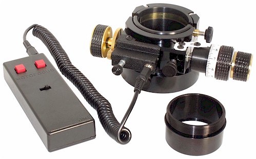

J'ai commandé ce crayford JMI Marc.
The Cassegrain version (EV-1c) is designed for use on 6" to 16" Cassegrain telescopes (e.g. SCT and Mak-Cas) with standard output threads. It includes an SCT threaded output adapter to allow use of standard SCT equipment on the output side of the focuser. The focuser gives 1/2" of travel and is designed for fine focus after rough adjustment with the normal telescope focusing knob
