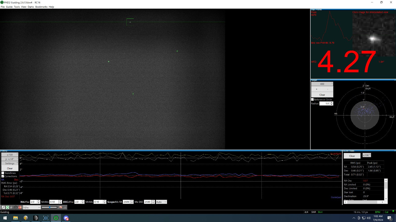

Hi Serge. Hope this discussion doesn't intrude on your vacation :)
If you are looking at long focal length imaging in general, it is well worth replacing the shaft bearings with precision grade ones. The commercial-grade bearings in the mount are permitted to have up to 25um of inner race radial runout, which means that when close coupled back-to-back a significant amount of 'swash' can occur when either axis is rotated. Nothing wrong with a little swash, but precision autoguiding and polar alignment is easier if the amount is small. The P5 grade variant of the same bearing (popular in toolroom lathes as a spindle bearing) has a limit on runout that is x3 times lower --> less swash and also less worm wheel runout as the axis shafts rotate.
With 35Kg of payload in addition it also makes sense to switch from lightweight aluminium shafts to a material with x3 times the modulus and therefore x3 times the torsional and bending stiffness, which will help maintain a respectably high lowest natural frequency.
I entirely understand your concerns about buggy products and thank you for raising them! In principle, nothing our little company offers is released without traversing our in-house product and process development lifecycle to the end, which is beta testing for some months by unconnected parties. The heavy-duty versions of our most recent product, which is field-retrofittable anti-backlash worm block assemblies are currently in beta test, following a year of intermittent design/development, then three months of alpha test by our company. For five years prior to this, we sold turnkey mount modernisations carried out by ourselves in Ireland, as something between a hobby and a business, a vacation from hands-on engineering R&D consulting if you will. This included installing antibacklash worm wheels (a unique development). There are a few of these kicking about around Europe and their owners are complimentary about their EQ8's.
We use what amounts to a 25 bit axis encoder, data-logged at 100Hz to test transmission errors of timing belt drives close-coupled to worm gear drives, on actual EQ8 mounts, in lab conditions. With this, we can clearly see meshing features and motor torque ripple and resonance effects that are not apparent when tested under sky conditions, and we have developed our technology guided by empirical testing, not just structural simulations and hand calculations. This has included private feedback to the mount's developer.
Tracking performance and durability in use are what counts obviously. There is more information about the first of these on our website under construction, to which you have a link. I confess we dont have robust information about life, as testing and reporting on this is almost impossible to do in a way that is meaningful for the use-cases our customers have.
The screengrab below of tracking performance using PHD2 is from a permanent observatory whose owner has the first of our commercially-built Twin-Saddle mounts, on our canted pier, carrying a 40cm RC on one saddle and a 6" APO on the other. With trimming weights the total mass is around 80 Kg. The worm gears used in this mount are similar to but not identical to the heavy-duty derivative you are interested in. The antibacklash worm wheel technology used in that mount can be thought of as an 'inside-out' version of the solution we are changing to. I think the tracking performance speaks for itself.

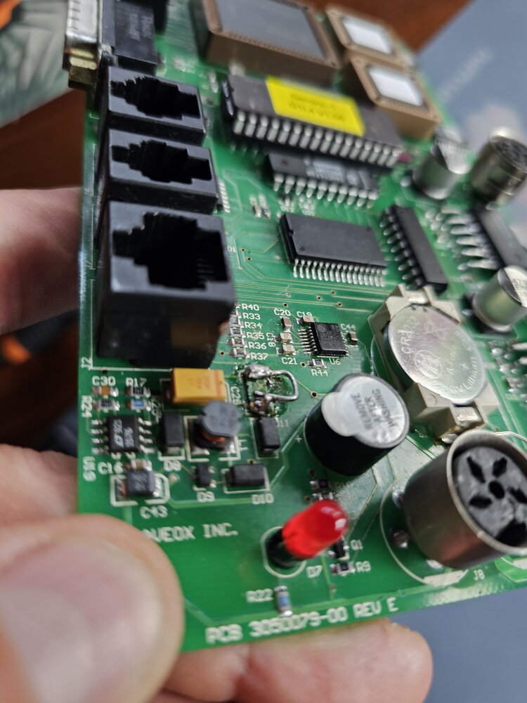

On n'est pas dans l'élégance mais la monture refonctionne !
les fusible remplacé par un papier alu, c'était le bon temps 😁

Alors oui, j'ai du ressortir un fer pas top avec de l'étain pas top et sans pompe à déssouder...avec une vue de vieux :)
C'est le mieux que j'ai pu faire !
Il s'agit d'un pb connu d'un fusible F2 (que David a évoqué d'ailleurs dans des posts) !
Certainement lors d'un arrachahe sauvage de cable moteur qui provoque un courant de bobine...qqc du genre...c'est à priori hyper répandu...c'est le fusible de la prise RS232...balo :)

La tresse à dessouder c'est 1000 fois mieux que les pompes ;)
Oui, mais Julien est resté bloqué à l'époque des composants traversant 😁
Après, si c'est pour bosser sur du 0402 du 0201 ou des QFN, ça change plus grand chose...

Oui, suis un musicien et je ne soude plus que des cables hein mainenant :)
Serge, du coup ça a guidé à 0.9" au global sur 4h d'affilé...le Gemini est donc reparti grâce à cette soudure :)
Pour combien de temps...bah on verra...David (où tu m'avais dit de prendre une EPROM) ne peut de toute façon pas regarder avant fin Septembre (plus d'atelier là  où il est in UK)..
Et Franck (OVISION) ne m'a pas répondu pour le moment...
Donc on verra.
J'ai mis deux nouveaux cables Gemini<->moteurs, introuvables, sauf ici !!
