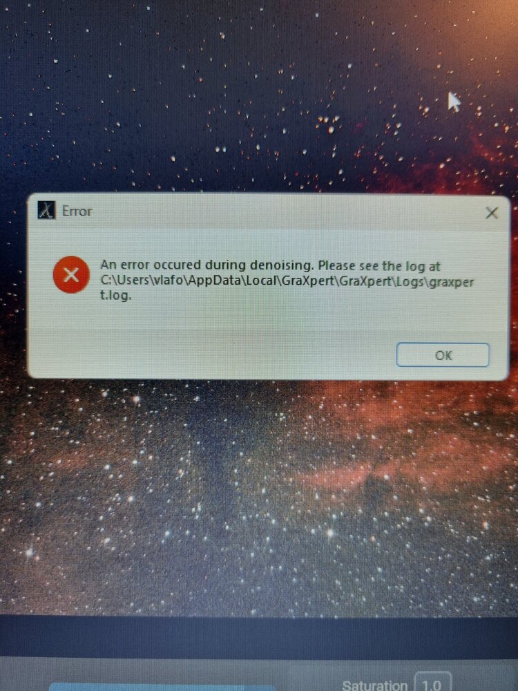

je n'arrive pas du tout à fair marcher GraXpert on linux, je suis avec OpenSUSE tumbleweed
si j'essaye par bash j'ai ces erreurs:
GraXpert-linux> ./GraXpert
2024-12-23 16:52:40,288 MainProcess root ERROR    Traceback (most recent call last):
2024-12-23 16:52:40,288 MainProcess root ERROR      File "/opt/hostedtoolcache/Python/3.10.14/x64/lib/python3.10/site-packages/cx_Freeze/initscripts/__startup__.py", line 138, in run
2024-12-23 16:52:40,288 MainProcess root ERROR      File "/opt/hostedtoolcache/Python/3.10.14/x64/lib/python3.10/site-packages/cx_Freeze/initscripts/console.py", line 17, in run
2024-12-23 16:52:40,288 MainProcess root ERROR      File "graxpert/main.py", line 298, in <module>
2024-12-23 16:52:40,288 MainProcess root ERROR      File "graxpert/main.py", line 292, in main
2024-12-23 16:52:40,288 MainProcess root ERROR      File "graxpert/main.py", line 89, in ui_main
2024-12-23 16:52:40,288 MainProcess root ERROR      File "/home/runner/work/GraXpert/GraXpert/graxpert/application/app.py", line 15, in <module>
2024-12-23 16:52:40,288 MainProcess root ERROR      File "/home/runner/work/GraXpert/GraXpert/graxpert/background_extraction.py", line 9, in <module>
2024-12-23 16:52:40,288 MainProcess root ERROR      File "/opt/hostedtoolcache/Python/3.10.14/x64/lib/python3.10/site-packages/cv2/__init__.py", line 181, in <module>
2024-12-23 16:52:40,288 MainProcess root ERROR      File "/opt/hostedtoolcache/Python/3.10.14/x64/lib/python3.10/site-packages/cv2/__init__.py", line 153, in bootstrap
2024-12-23 16:52:40,288 MainProcess root ERROR      File "/opt/hostedtoolcache/Python/3.10.14/x64/lib/python3.10/importlib/__init__.py", line 126, in import_module
2024-12-23 16:52:40,288 MainProcess root ERROR    ImportError: libgthread-2.0.so.0: impossibile aprire il file oggetto condiviso: File o directory non esistente
avez vous des pistes?

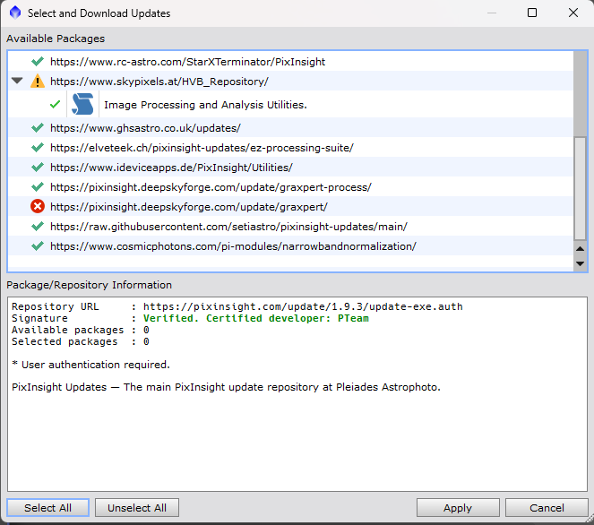

  Le 21/05/2024 à 11:38, CCD1024 a dit :
Graxpert 3.0 n'est maintenant plus appelé par un script mais un PROCESS
Il faut effacer le repository "... all in on" et le remplacer  par " https://pixinsight.deepskyforge.com/update/graxpert-process/  "
Le process graxpert sera dans les process.
La 1ere fois, il faut bien sur lancer Graxpert 3.0.2 avant, faire les 2 traitements (gradient et denoising) sur une image afin qu'il charge les 2 fichiers IA.
Ensuite, sous pix, plus aucun soucis.
La doc est ici
GraXpert Suite pour PixInsight Guide Rapide (deepskyforge.com)
Voir davantage

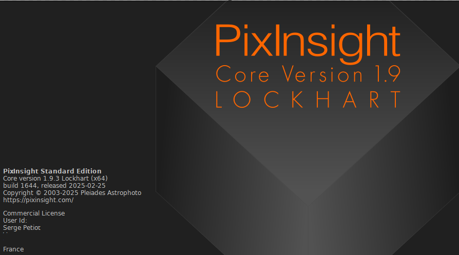

bon, j'ai fait évoluer mon PI "Ripley" à "Lockhart" . J'ignore ce que ça va m'apporter de plus, mais bon...
Concernant mes script et process, il m'a gardé ma liste ce qui est cool:
Mais apparemment, j'ai une vieille ligne de GraX qui apparemment n'est plus utilisée. Je peux la supprimer, Vous confirmez?
