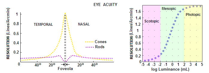

J'ai trouvé quelques précisions sur cette différence de résolution entre cones (cones) et batonnets (rods), impressionnant, le rapport est bien de 1 à 10...Mais on voit que la résolution des cones varie selon leur position centrale ou décentrée, sur la rétine.(Site : http://www.telescope-optics.net/eye.htm)
FIGURE 128: Left, average resolution of cones and rods over the retina, in lines per arc minute. To the right, resolution in lines per arc minutes as a function of illumination level, for the photopic (bright-light), scotopic (low-light) and mesopic (transitional) eye modes. Maximum rods resolution is somewhat over 5 arc minutes, a fraction of the maximum resolution of the cones. Resolution of rods in inferior due to their input to the eye nerve coming bundled a number of rode photoreceptors. Cones, on the other side, send individual inputs to the eye nerve; with the Airy disc for a typical 2mm photopic eye pupil diameter being ~1.6 arc minutes, diffraction resolution (defined as the FWHM of the PSF, or 0.4 of the Airy disc diameter) is in the 0.6'-0.7' range.eyeresln.png
