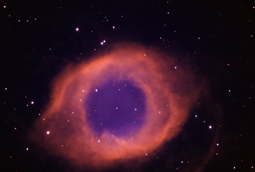

Un peu de couleur et une image un peu plus 'travaillée' pour terminer...
Toujours par Stuart Thomson..
Helix Nebula
"This image was taken over a two night period in November 2008, in Hydrogen alpha and Oxygen III wavelengths. The separate images were then combined in Photoshop and a synthetic green channel added."
Telescope : Meade RCX400 10" f/8 (operating at f/6 with the use of an Astro-Physics 0.75 focal reducer.
Camera : SBig ST-10XME, CFW8a, AO8.
Exposure : Ha 150minutes unbinned, OIII 60 minutes binned 3x3.
Subexposures aligned and combined in CCDStack, final editing in Photoshop.
