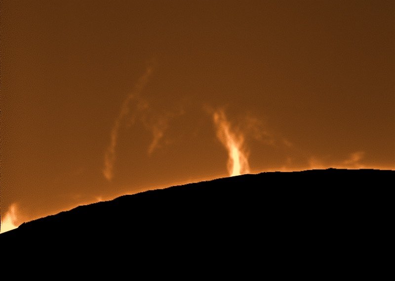

The image was made with a modified PST with 4" aperture and a focal ratio of f/10. Processing chain was Avistack, Fitswork and Gimp.
I hope you're not getting sick of the hypnosis, Xavier!
Hi,Michael:).Great pic:wub:!

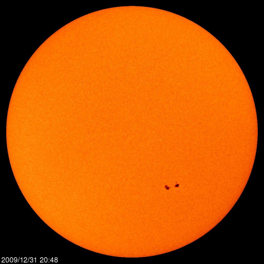

Allez, les 1ères taches Solaires de l'année 2010 pour bien commencer ;).
Edit : bon, l'image de Soho date d'hier-soir 20h48.
