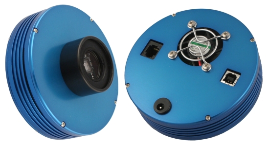

Voici la caméra tant attendue. Un peu décevante pour tout dire. j'attendais un ICX285 à 30 fps voir un KAI-0340DM
The new Atik Titan is essentially a dual-purpose CCD camera that features a cooled Sony ICX 424 Sensor that can also operate at 15 frames per second in high-speed mode making it of interest to both deep-sky and lunar/planetary imagers.
The Titan would also make an excellent ultra-fast autoguider!
First deliveries are expected mid-late April.
