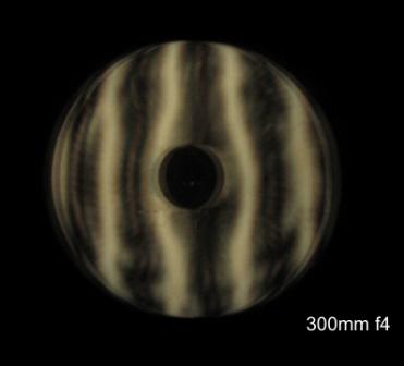

Bonjour a tous. Comme promis je vous fais suivre le retour OO concernant les pièces optiques non conformes aux bulletins de contrôles fournis
(Sir, we receieved back today your mirrors. We have just tested the 300mm and, on a double pass Ronchi test with 13 lines per mm, the overall surface is not good. It is one of the 6 mirrors that left our premesis made by one of our ex-employees.
I attach the photograph of the mirror which shows:
Irregular surface
Over correction
Turned edge.
We will of course commence rectification on this mirror and, the others as they are tested. Would you like these sending to you as they are finished or, all at once, which will take up to about a month depending on their current situation?
My sincere apologies for this large error on our part. Current additional, fail safe quality procedures will not allow such mishaps again
Best Regards
Barry Pemberton
Managing Director).

Oui, mais surtout la tronche du star test.
Mais par contre le ronchi est plutot bien....
On aura une réponse en septembre, quand OO aura recontrolé le primaire
